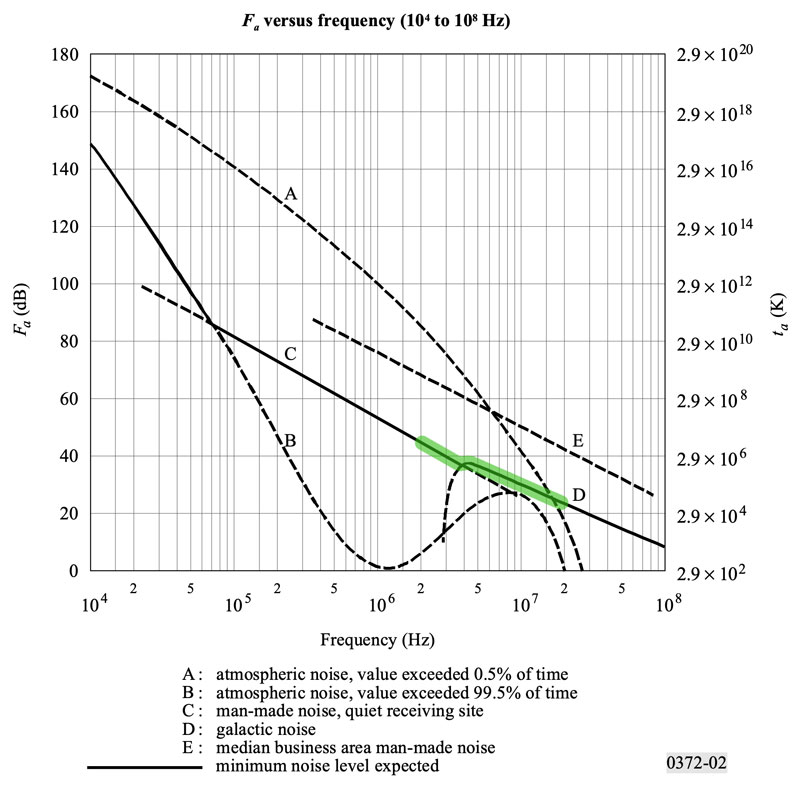

Manmade and environmental noise will travel the same path as desired signals, raising the noise floor at the receiving end of the BLOS path. These noise sources are prevalent the lower HF bands and significantly raise the noise floor and shown in Figure 1, Atmospheric Noise Floor1. The minimum noise is highlighted by the green line (C & D) while a more worst-case noise level from an urban setting is noted in the line marked E. Note that the Noise Figure (Fa) is significantly higher at 2MHz than at 30MHz. In this case, line D shows the noise figure at 2MHz is approximately 45 – 70dB while at 30MHz it is closer to 20 – 40dB.2
Directional antennas can provide as much as a 10dB improvement of these numbers from elimination of noise in some directions because of the directivity of the antenna. Receiver sensitivity should be set to receive signals just below this noise floor (so as not to add to the noise level), but sensitivity beyond this level provides no benefit since signals will be lost in the atmospheric noise floor. These noise figure numbers will come into play when we look in detail at dynamic range.
